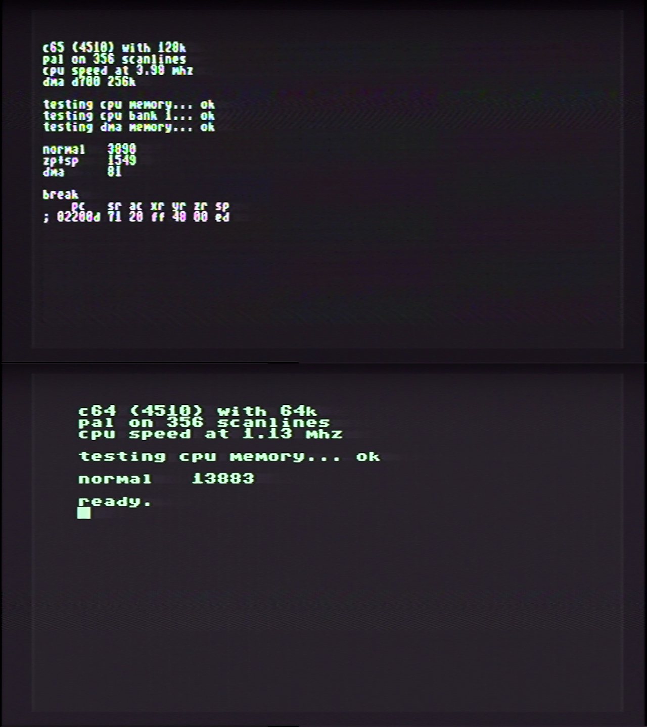

Thank you, Miro! Good to see it works... er, it almost works. Where have you tried and which version (v1.04 should be)? Some of the results seem a little strange to me, that reminds me more of an emulator test.
- it should display "mega65" instead of "4510" if recognized (so my autodetection still fails!)
- 356 scanlines (?)
- the DMA seems way too fast (only 81 cycles for a one kilobyte transfer?)
- it should return to Basic in the end (but breaks at $2200)
Does the MEGA65 not boot up in the 48 MHz mode by default? (It is only in the 4 MHz mode here.)
The C64 mode is ok, yet I need to do a lot of bugfixes for the C65 mode, I think. If anyone still tries it, please try the native mode, and both these ways:

May I have a question? What should be the best or surest way to fast and easily (in only a few steps) distinguish the MEGA65 from C65?
I have done it in my code by switching to VIC-IV mode, then switching back to VIC-II mode, and comparing if some special registers (like $d031) change their values according to this (since they must be hidden for the VIC-II and normally just contain $ff there).
But now (if Miro's test was done on a MEGA65) this method does not seem to work.
Also, I thought the intruction set and timing were changed for C64 mode. But then they should be 6510 and 0.93 MHz (instead of those 4510 and 1.13 MHz).
Of course test was done on Nexys4DDR running M65.
Screenshot is from PEXHDCAP downscaled 'cause device supports up to 1080p.
I was surprised with result, but now see that Memtest needs fixes.

Thank you for your answer! I try to learn from the results, and investigate which one is my fault (even if it is not easy without the hardware).
At first, I need to think out a better way of autodetection (as I have already written that above). Yet, I am not so sure about the other things.
Those 356 scanlines are really weird. But these are here just simply recognized. And it works well everywhere (even on the Plus/4 and VIC-20 etc.). As well as the MHz of CPU. So these must be no problem.
That super fastness of the DMA is also rather surprising, still I think it MUST work here. (If the DMA would not work, then we should get an "error" in the end of that test instead of "ok" if the needed bytes are not copied and do not match.) Probably the DMA is always executed by the FPGA at the maximal speed ever possible (independently of the actual CPU speed setting). Or does it go in parallel (not stopping the CPU)? (If so, then I would need to wait until it's done.)
I have already got an idea for the final crash (its breaking into monitor). Obviously, it must happen at the final RTS (when returning to Basic). So I consequently consider that it must be a STACK problem. Most probably the contents of the stack are overwritten (and not restored) somehow.
When testing the ZP+SP method, I extensively use both the relocations of the Zero Page and Stack Page (throughout the memory). Maybe are these features just not well (or not yet) implemented by the MEGA65?
It works fine in the MESS emulator though.

Monitor output - if you mean 80 columns mode - is output from M65 native mode, image is from 2 screenshots (top = native / bottom = C64 mode)
So, C64 can have 80 columns mode, but in 320x200 pixels, so 4x8 characters.
Miro

To detect a MEGA65, write $47 then $53 to $D02F instead of the C65 knock values. If you see VIC-III registers, you know for sure you are on a MEGA65, as a C65 will not recognise this knock.
As for the CPU and DMA:
1. At present the M65 only uses 4510 CPU mode. 6502 mode is partly finished.
2. CPU runs at low speed unless you ask for high speed. Fast way to ask for high speed is POKE0,65. POKE0,64 puts it back to normal. All other access to address 0 is normal.
3. DMA ignores CPU speed, and always runs at full speed, 48MHz on older bitstreams, 50MHz on newer ones.
4. The little CPU speed difference is due to some residual instruction timing differences, partly 4510 reduced cycle count for implied mode instructions.
Paul.
Thank you, Paul. That's exactly what I am doing, of course. Maybe only not succeded because I assumed they give back $ff when hidden (as normally on a C64), but you rather set them to $00 (or any other value). In the next version, I try to make it a little more flexible for any case.
Are the Zero Page relocation, and the 16-bit Stack Pointer handling implemented on the MEGA65, in the same way as on the C65 hardware? As I described my other problem, it seems to go wrong with something about these.
@rosettif: 16 bit stack pointer (and the E bit in flags register, CLE/CEE etc) and relocatable zero page ("base page" since it's not always the zero page strictly, any more hmmm) is the same. Or it should be. It sometimes turned out that actually C65 hardware does not do what it should, at least there was a case when it turned out that (ZP),Z addressing mode not working for real on every (or all?) real C65 units even if we know it should, by specification too ...
