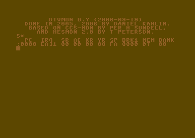

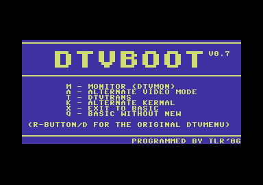

  • New version:
    • screen shot function activated by holding '<-' + reset.
    • an alternate kernal at $1fe000 may be activated by pressing 'K'.
      (suggested by peiselulli)
    • the video mode maybe toggled back and forth between PAL/NTSC.
    • exiting to basic without doing new is selectable by pressing 'Q'.
    • the stand alone binaries are now compressed.
    • the original DTVMENU can be loaded by holding the right button.
    • nicer look.
    Download: dtvmon-0.7.zip
