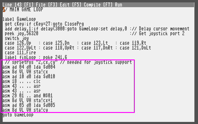

    So I tried tweaking the code to comment that part out (the sprSetPos call), and instead replace it with some inline asm code to read the current spritePlease login to see this link. location and place it in cx and cy vars, as below:
    I 'think' the logic of the code I added is fine, but when I try to rebuild and run the game, I run into problems:

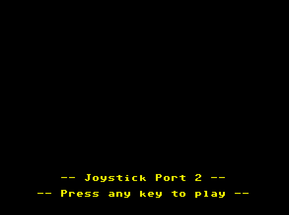

    No artwork shows for the title screen:

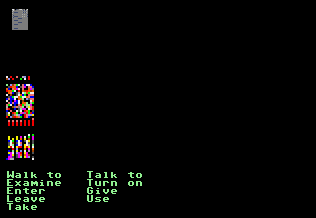

    ...and the in-game graphics seem corrupted too :(
    At least some good news is that the mouse does indeed move the pointer now (which is that grey blob in the top-left at present), though it seems to ignore mouse clicks for now.
    Just wondering if you had any idea what I might've done wrong? Perhaps my addition muddled up something related to the loading of the bitmaps? Though I'm not sure how :)
  • Aah, maybe there's something else at play.
    Just noticed that even if I build the original source, I get the same issue.
    It seems to relate more to the way I choose to load the compiled PRG afterwards...
    It fails this way, if I use:
    • LOAD "TEMPUS.PRG", it will fail this way
    • ^ "TEMPUS.PRG"
    ...but if I load it either of these ways, it loads normally:
    • SHIFT + RUN-STOP (to load it as the first thing off the disk)
    • RUN "TEMPUS.PRG"
    Not sure what the distinction is, but good to know I can avoid the problem this way... So I'll try my tweak again and see if it works... :)
  • Ok, tried again, ran it with SHIFT + RUN-STOP, got the mouse moving fine, but clicks don't seem to register yet, I can try look into that next time...
  • Aah, I think it was a xemu bug that was causing my issues. It seems that xemu's mouse support is a bit limited, and tailored to work as mouse on port 1.
    All mouse movements in xemu are sent to both ports 1 and 2, but mouse clicks are only sent to port 1.
    As this game was polling joyport 2 only, that's why it couldn't detect the mouse clicks for port 2. I'll let LGB-Z know :)
